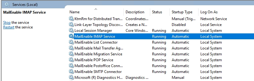

So the script is currently set to update settings for “IME_SYSTEM” (not “IME_ADMIN”) so you need to figure out what user account your Mail Enable service runs as then target that account in the script instead (i.e. change IME_SYSTEM to the correct user account).
Hi and sorry for my slow response. I been crazy busy the last couple of days :smiley:
Well in the services.msc console it looks like this:
So it runs on the standard local system user it seems?
Thanks in advance.
Kind regards
AngryWarrior.
OK. Try just changing the script to use IME_ADMIN that should at least work without error, then see if the mailenable certificate settings UI can see the certificate.
