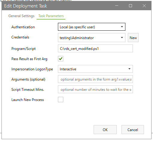

Hi @neatpinkshark - the app has a bunch of built in deployment tasks to do various things and one of them is Run a PowerShell Script, you should use this for most custom scripting as it can be passed the details of the renewal object, see the scripting docs for more info: Scripting | Certify The Web Docs
Your error message about shows you were trying to use the Run a Script task which on windows runs a .bat file and on linux would run a shell script etc.
If using powershell you should not try to determine the certificate details (thumbprint etc) yourself because this information is already provided in the $result param. As certs can have multiple domains includes matching on subject is a little non-specific.
Before writing your own script check if our basic deployment tasks will work for you, some of which use these scripts: certify-plugins/src/DeploymentTasks/Core/Providers/Assets at development · webprofusion/certify-plugins · GitHub
A renewal can have multiple deployment tasks and you can set whether they care if the last step failed etc.
Hi @webprofusion, thank you for your quick response! I somehow managed to entirely miss the “Run a PowerShell Script” task…in my defense, it was a long week and I already had one foot in the weekend :slight_smile:
I’ve reviewed the documentation you suggested, and while I may be missing something it appears to be setting the certificate for the Gateway, but I don’t see where it sets the certificate for the other roles, “RDRedirector”, “RDPublishing”, and “RDWebAccess”.
My script seems to be doing all of what I need it to do, and (thanks to you pointing out the “Run a PowerShell Script” task) it is running via Certify the Web console job, but I’m having issues modifying it to test/use the $results param as you mentioned above. I created a script to output the properties and variables of the $results param and added this as a job in the Certify The Web console, but the output appears to be null:

Thanks, you just use 3 backticks to start a code block on your forum post then close the block with another 3 backticks (edited it for you).
Does your script start with param($result) - that’s how powershell scripts accept input parameters and that would be how $result should get populated. See more examples at Scripting | Certify The Web Docs
The property for the thumbprint is $result.ManagedItem.CertificateThumbprintHash not $result.Thumbprint as the toplevel result is the status object of the renewal. Other than that it looks ok to me, I think.
Thank you @webprofusion, that ended up working!
Here is the corrected code that did the trick:

Hi KTC,
Did you ever get this working I am having the exact same issue.
The “Object reference not set to an instance of an object” I think is due to what Powershell is doing when it attempts to run Set-RDCertificate.
I took your script apart until it was just the very basic commands to renew the cert, I even hardcoded the thumbprint (purely for testing)
When I run the script manually via ISE it works perfectly, as soon as I tell CTW to run it, it fails.
What I suspect is happening is the credentials being used to run Set-RDCertificate are not correct, it appears to call other commands which then fail and the error of those commands is “Object reference not set to an instance of an object” (I think it has issues finding the farm when run as the system user since it uses Invoke-Command at some point)
Heres what I am using at the moment for reference.
param($result)
# Import required modules
Import-Module RemoteDesktop
#$Thumb = $result.ManagedItem.CertificateThumbprintHash
$Thumb = 'xxxxxxxxxx'
$CB = "DC01"
Set-RDCertificate -role RDRedirector -thumbprint $Thumb -ConnectionBroker $CB -Force
Set-RDCertificate -role RDPublishing -thumbprint $Thumb -ConnectionBroker $CB -Force
Set-RDCertificate -role RDWebAccess -thumbprint $Thumb -ConnectionBroker $CB -Force
Set-RDCertificate -role RDGateway -thumbprint $Thumb -ConnectionBroker $CB -Force
Restart-Service -Name "Tssdis", "W3SVC", "TSGateway" -Force
Just wanted to report back that I did actually get this working if anyone else comes across this.
The script posted above DOES work but you need some specific settings within the task in CTW for it to run successfully.
See below screen for the settings that got it working for me, hope this helps someone.
