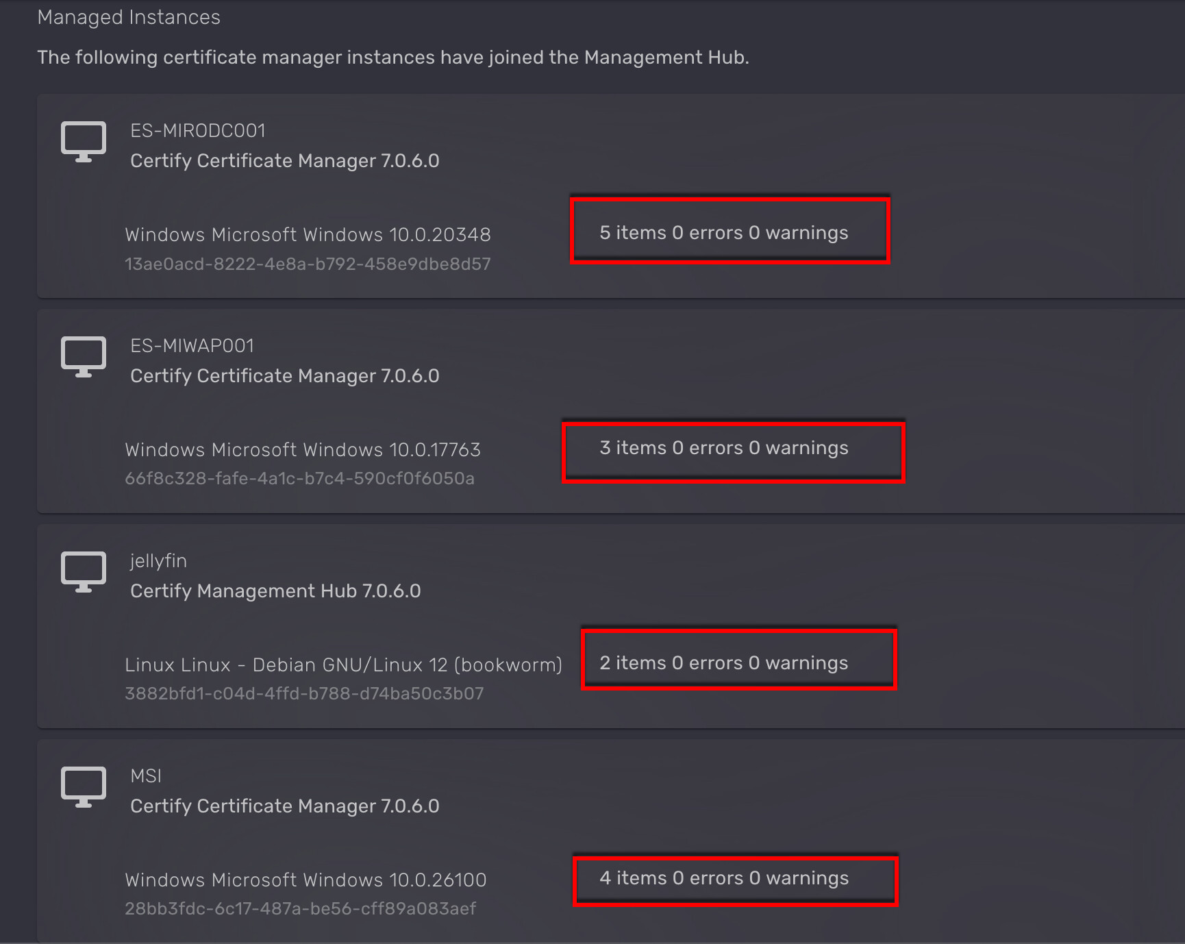

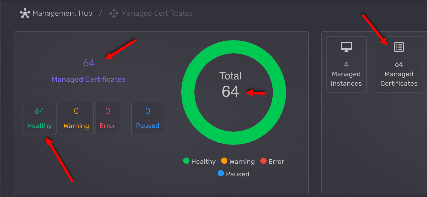

Only caveat is that for some reason new version is reporting an insane amount of certs, obviously duplicated, but only on upper side of Summary section. Cert list at the bottom of same section only shows real cert number, as expected.
If I check Managed Instance List, I see the right number of certs per installation connected.
It’s not a big problem, but it indeed started happening after upgrading all clients (Windows and Linux) to latest version.

Thanks for reporting that issue with the managed certificates total, and also for trying out the multi-instance management.
We’ll have a look to see if we can find an issue with double-counting of statistics, it could be that the instances are re-connecting with a different connection identifier and the stats are doubling up. Presumably if you browse to your managed certificates there are no duplicates shown in the list?
@esmiuser further to the issue with summary counts being wrong, I think this is caused by external certificate monitoring, e.g. if you have any other supported ACME clients installed on any of these instances their numbers will be counted [possibly even double-counted] in the summary but not in Managed Instance counts.
Obviously if you don’t have any external cert managers then that’s not the problem, but if you use acme.sh, certbot, Posh-ACME, win-acme or simple-acme then it could be.
