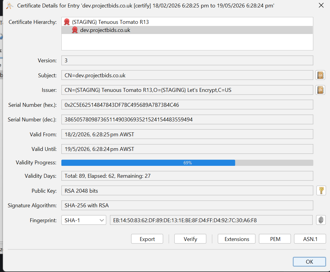

The first thing to check is that the PFX under C:\ProgramData\certify\assets contains what’s expected (usually at least one intermediate), I would suggest using certutil or Keystore Explorer.

I am seeing the same. PFX shows the intermediate cert but the intermediate cert is not being installed. Server is locked down but I have allowed the following.
Thanks, we’ve seen that if servers a blocked from making outgoing http/https requests to Microsoft that also can mean that intermediates don’t get installed automatically. We will include a fix to optionally install the supplied intermediates (for non-staging requests) in the next update to v7.x
