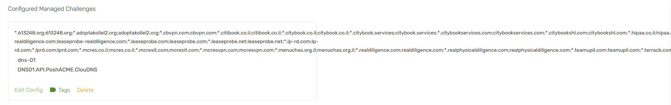

I have a computer JOINED to the CMH. I am actually trying to do everything via the CMH. I have setup https and it appears to work, and I was able to join the computer.

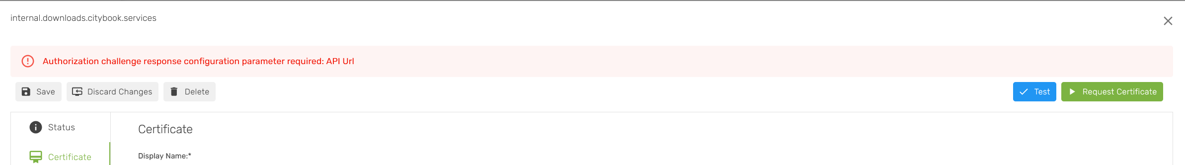

I am currently using DNS-01 with ClouDNS on the local machine and everything is fine. I have added on the Hub to Managed Challenges the ClouDNS entry (question about that in a second). I try to change the server to use a managed challenge. It insists “Authorization challenge response configuration parameter required: API Url” but according to the DOCS (Managed Challenges | Certify The Web Docs) I don’t need to specify the URL (since as specified I am hub joined).

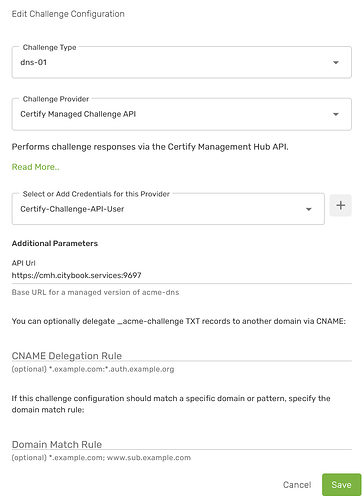

If I do specify https://cmh.mydomain.services:9697 (okay valid but that isn’t the domain and it isn’t avaliable externally) I get an error (twice).

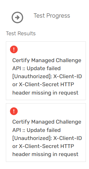

Certify Managed Challenge API :: Update failed [Unauthorized]: X-Client-ID or X-Client-Secret HTTP header missing in request
So either I’m doing something wrong, or it isn’t working yet?

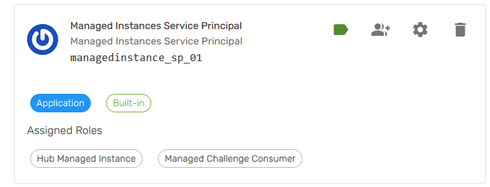

Sorry, my bad. I failed to note that the account managedinstance_sp_01 (auto created), I added the role Managed Challenge Consumer. Yet I am still unable to actually access the managed challenges with the errors listed in the first message (I had already added the role).
Did you add/select the credential to use in the dropdown? Currently the app doesn’t auto-use the joining key for API auth, in the next version it will.

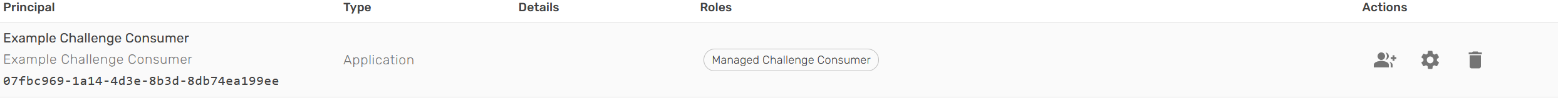

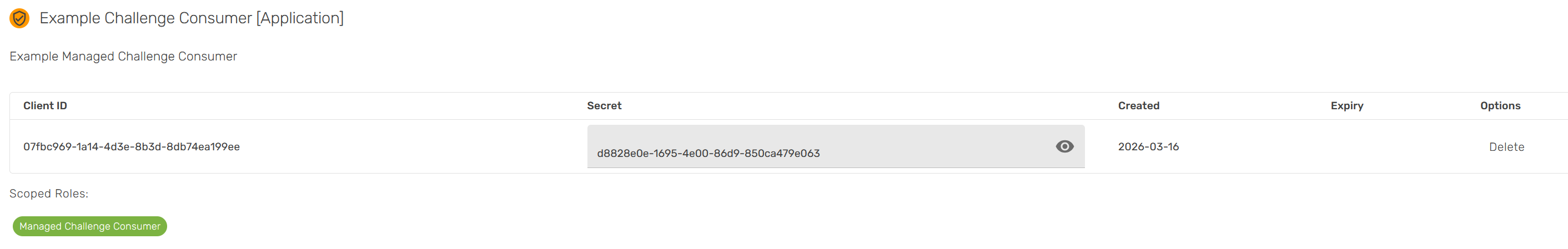

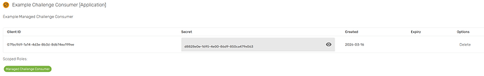

Here is an example using the current method (configuring an API key for a specific application security principal), where I have configured an API key for a Security Principal and scoped it the Managed Challenge Consumer:
The new application Security Principal exists under Users with Managed Challenge Consumer role (UI is slightly different in our dev version):
API Key added for that security principal and scoped to the Managed Challenge Consumer role:

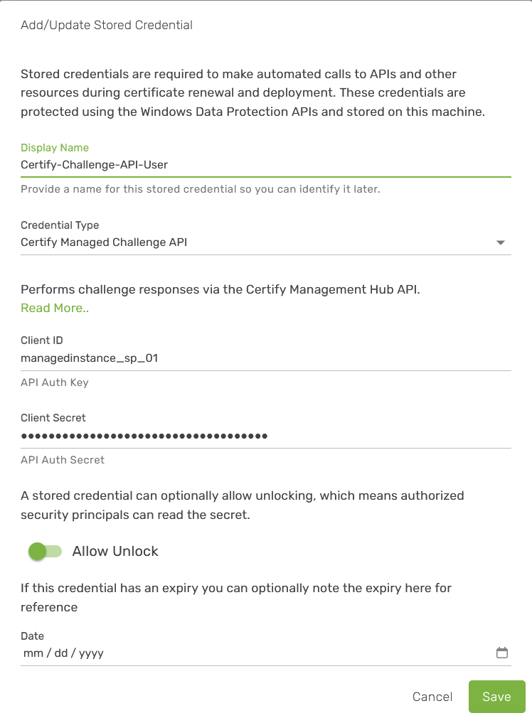

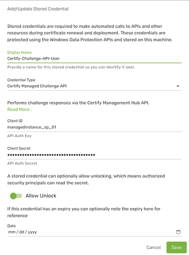

Adding the stored credential again (just in case)…

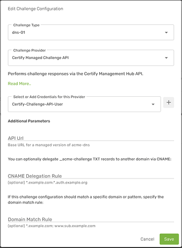

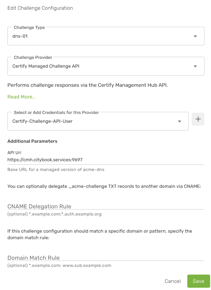

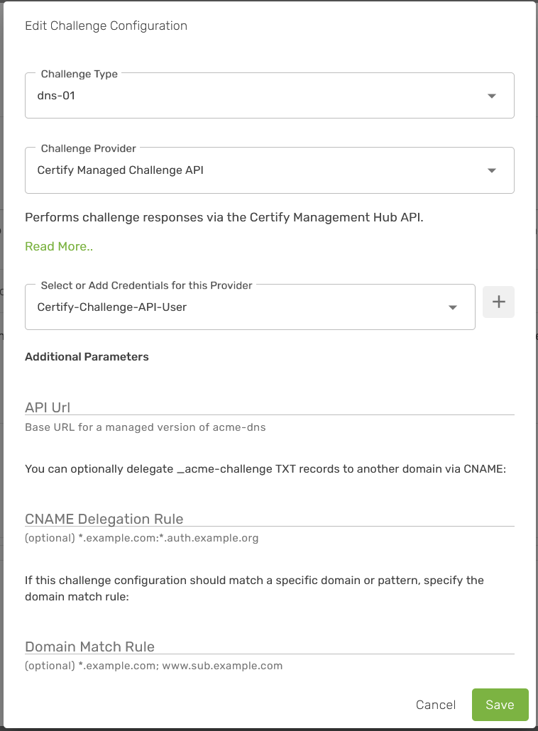

Challenge configuration
Fail1
Add URL
Fail2:
So I am following your setup but it isn’t working!
Thanks for trying that, what’s odd is that the API url field isn’t called “API Url” in the code and hasn’t been a required field for about a year, which suggests there is some stale configuration being loaded perhaps from the previous DNS provider configuration.

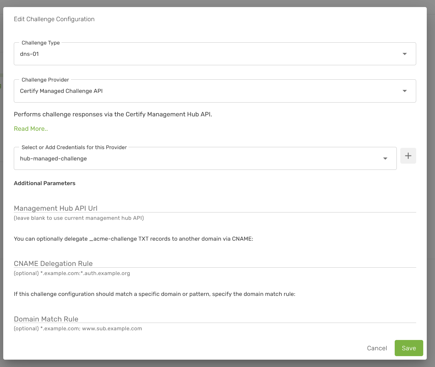

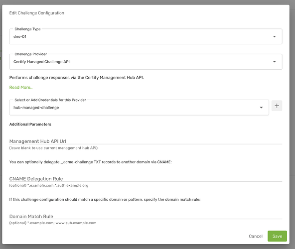

Could you try deleting the Challenge Configuration and add it again? This time select the credential but try it without the hub API url.
Can confirm this behaviour on a completely fresh install of 7.0.17 management hub. There are two bugs here. One the form is not updating correctly from the default “Certify DNS” option - if you switch directly to “Certify Managed Challenge API” the API Url field sticks from “Certify DNS”. If you choose anything else first and then “Certify Managed Challenge API” the form gets correctly updated and shows the optional Management Hub API URL.
The second is that it unfortunately still runs into the Unauthorized error even with this “trick”
In 7.0.18 we have a new method (docs to be updated) which lets you assign the “Managed Challenge Consumer” role to specific instances, and optionally restrict that by tag.
This way the auth happens automatically without the need for additional API keys and minimal config per instance/managed cert, and you can scope access to specific instances easily.
  • Under Settings > Security > Users > Managed Instances, click the roles icon (people+), assign Managed Challenge Consumer , optionally with a specific tag filter (like an environment, dept or application tag that’s already in use). Clicking the eye icon will show which items this role assignment gives access to.
  • Tag your managed challenge with the same tag (if you are tag scoping access).
In the app, set authorization challenge type to dns-1, Certify Hub Managed Challenge API. Leave everything else default. Click Test to try a test managed challenge (the hub should create _acme-challenge-test records and remove them again).
