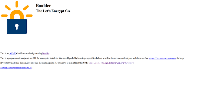

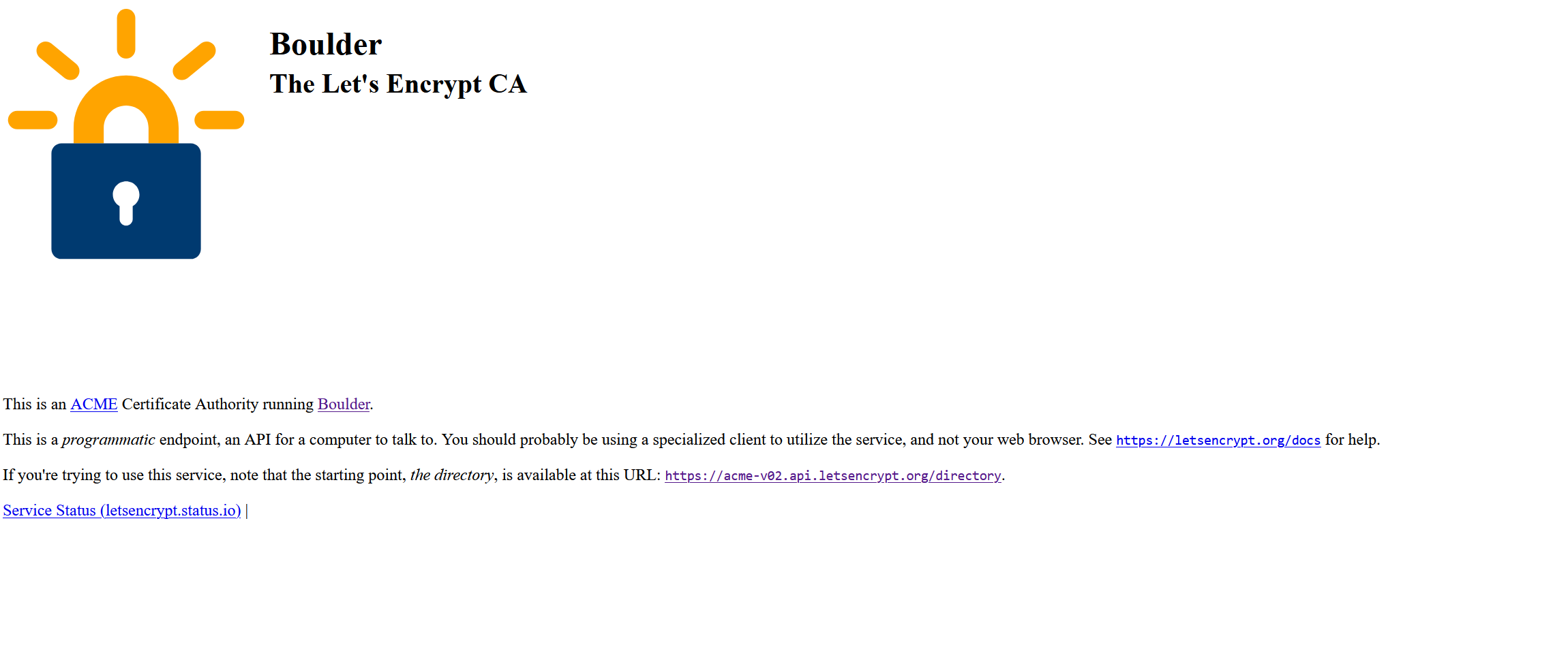

note that https://api.certifytheweb.com doesn’t load in a browser even on a system with no restrictions, so maybe using a browser as a test for that isn’t accurate?
https://acme-v02.api.letsencrypt.org does load a browser page on an unrestricted system.
It should return an HTTP 404, which is a valid response, but not necessarily that intuitive.
You can try https://api.certifytheweb.com/v1/update instead.
In an unrestricted system the Let’s Encrypt API should look like:
